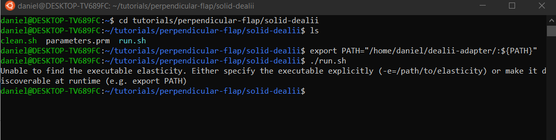

Dear community, I recently installed the PreCISE adapters for FSI simulation and was able to run the simulation using OpenFOAM and calculix. However, when I am trying to run the fsi related to the DEALII adapter it’s not working. when I run the fsi it shows “unable to find executable elasticity”. I came across a user’s post for the same and I tried to do the same but nothing seems to work. I have attached the screenshot for the same.
I would be glad if anyone can help me with the problem.
You export /home/daniel/deal-adapter/, but the directory is actually called /home/daniel/dealii-adapter/ (see the extra ii). Could this be the error? If not, could you show the content of /home/daniel/dealii-adapter/? Is there a file called elasticity?
A great way to avoid such typos: use that Tab key to auto-complete paths. It is a life-saver!
Sorry, I made a mistake, but it’s still not working!

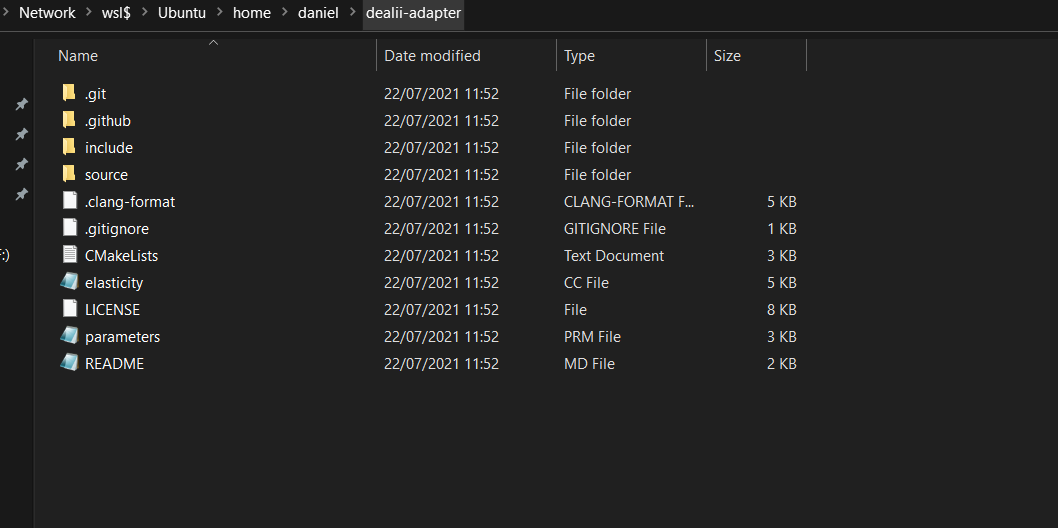

There is a file named elasticity.
Below I have attached the screenshot of both
Hi @daniel,
according to your explorer, there is just cc file called elasticity. You need to generate the executable before you can run the tutorial. Checkout our installation instructions: Get the deal.II adapter | preCICE - The Coupling Library
Yeah, just as @DavidSCN is saying, there is a file called elasticity.cc. You need to tell Windows to show file endings to actually see it . If you change into the directory using you Ubuntu terminal and check files via
cd /home/daniel/dealii-adapter/
ls -l
you should see the file ending. You need to follow the steps suggested by @DavidSCN to create the actual executable which will have no file ending.

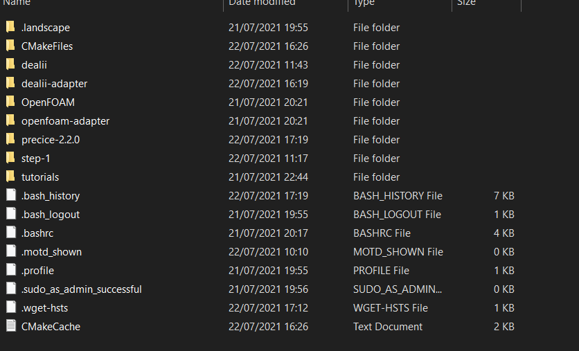

Dear David, I was able to do what you told me. But I doubt whether the elasticity file is still executable.
This looks good. Maybe the third step in the set of building instructions on the website is not obvious enough, but if you execute now make in the directory you are in, everything should work like a charm.
The elasticity file is still not executable !

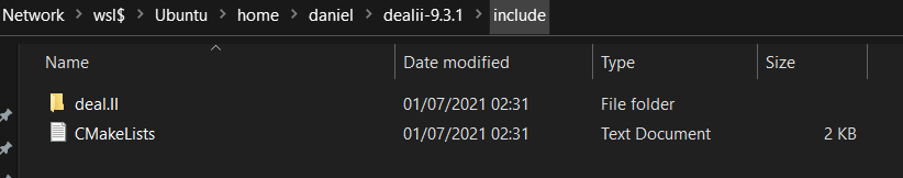

Hello David, you were right I had deal.II version 9.1. I uninstalled it and I downloaded the version dealii-9.3.1. from the official website. Following the steps from the official website it says
mkdir build
  cd build
  cmake -DCMAKE_INSTALL_PREFIX=/path/to/install/dir ../deal.II
I did the above two steps, but when I try to do the third step its not working. The error is pictured below, even though there is a directory named deal.II
I think you are missing someting at the end of your cmake command. It does not look like you are specifying the directory containing deal.ii.
Maybe you have to call something like
cmake -DCMAKE_INSTALL_PREFIX=/home/daniel/dealii-9.3.1/include/deal.II ..
or
cmake -DCMAKE_INSTALL_PREFIX=/home/daniel/dealii-9.3.1/include/deal.II /home/daniel/dealii-9.3.1/
I must also admit that your installation prefix seems a bit odd to me. Do you really want to install deal.ii in the directory /home/daniel/dealii-9.3.1/include/deal.II?
