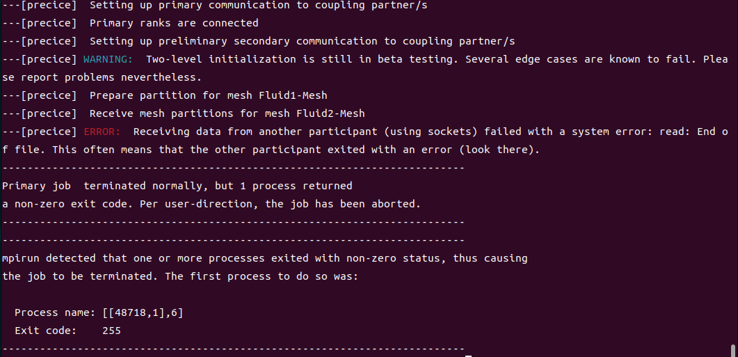

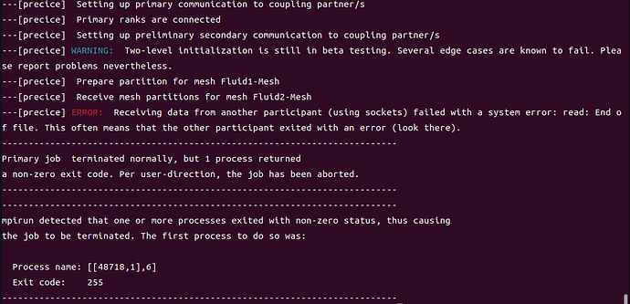

I am studying the partitioned-pipe case in the tutorials. I set the intra-participant communication to : <intra-comm:sockets port=“0” network=“lo” exchange-directory=“.”/>, and I used two-level initialization: use-two-level-initialization=“true”. I found that there would be errors as shown in the picture, but when I used <intra-comm:mpi exchange-directory=“.”/>, there would be no errors. The preCICE version I installed is 3.0.0. How can I solve this problem?

Hi @lzx,
as the error message states, you need to look at the other participant for more useful information. What does the other participant report?

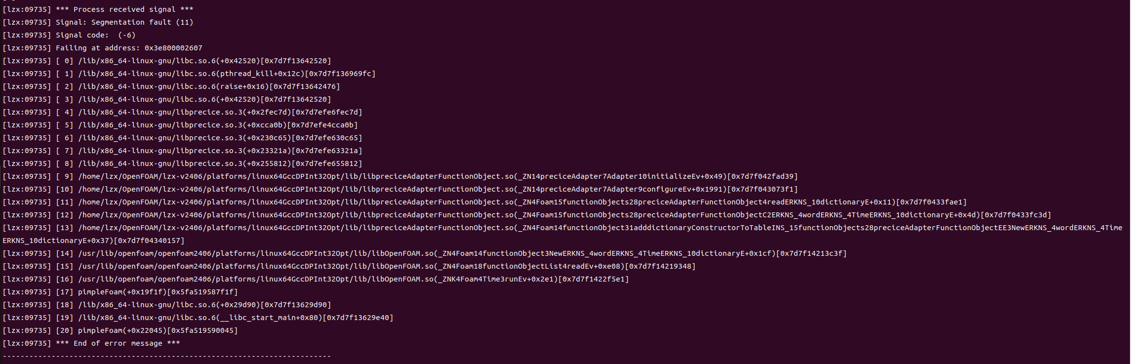

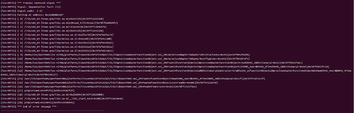

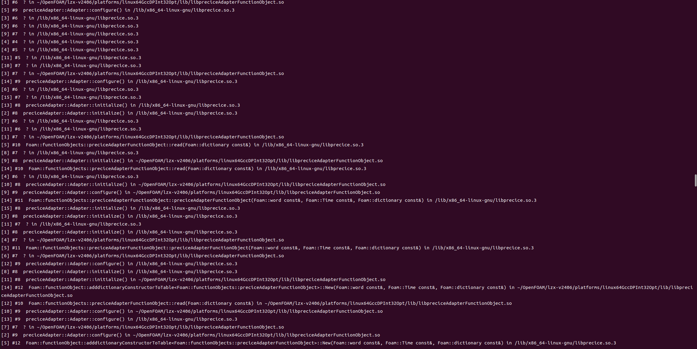

Hi! the other participant report some information about openfoam and segmentation fault in these photos:
I have set openfoam run in parallel mode,and I test flow-over-heated-plate case in the tutorials,the same problem occured.
@lzx the error message is still not visible in this image: I only see that the issue occurs in the initialization. Screenshots will not help, please upload two text files with the complete output of both solvers.
