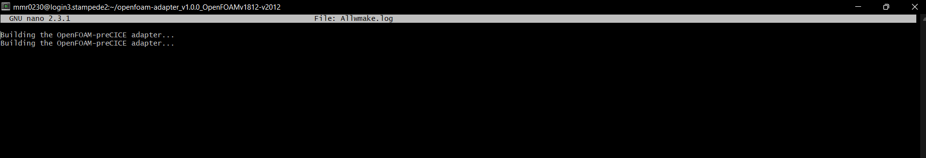

@DavidSCN, It does not generate any of those files. Just an Allwmake.log
Could you upload the Allwmake.log?
Allwmake.log (82 Bytes)
@mishal49 this output looks very strange and unexpected. I don’t understand:
  • why it prints this line two times
  • why it does not print any of the next lines (they are just echo commands).
Since I see you are running on a remote system, I suspect that something went wrong there temporarily. Did you manage to resolve it?
