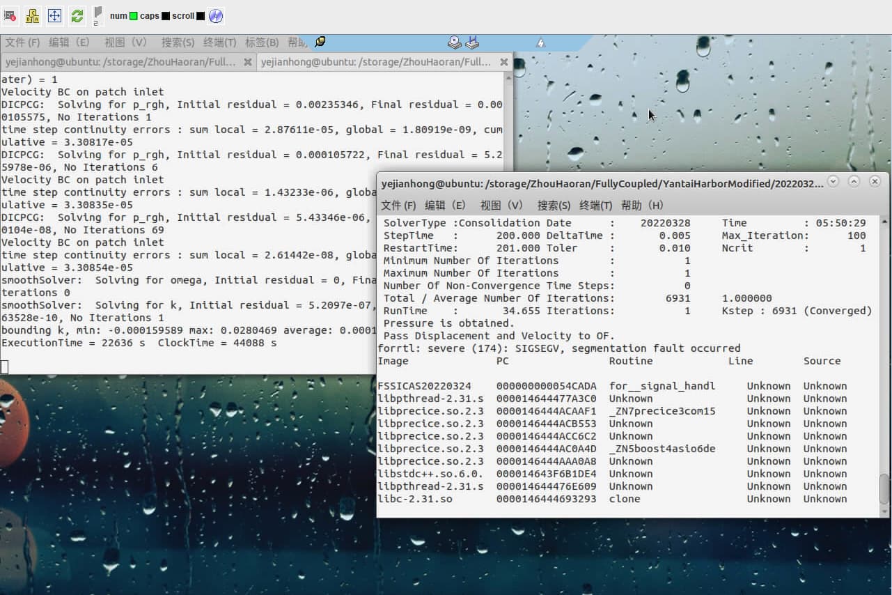

My colleague and I are currently identifying whether the problem is caused by our in-house solver or preCICE. The error message is shown in the following picture:
If the seg fault is caused by preCICE, there will be some prefix like --[precice] ERROR, right?
It is very difficult to understand what is going on here, due to the many parts marked as “unknown” in the trace. It looks like the segfault is essentially triggered inside preCICE and it is related to the communication (I see boost asio, precice com, and libpthread). But this could very well be caused by external factors. I guess we could only get more information by rebuilding preCICE in debug mode, but I also guess you don’t want to repeat hours of simulations. Since it is triggered just by time, it could also be some communication buffer access issue (maybe @fsimonis could have an idea here, then).

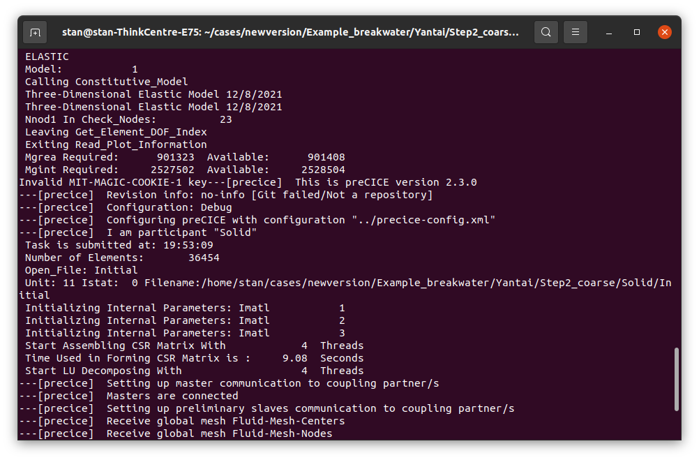

Since our server has some networking issues, I didn’t succeed in recompiling the preCICE source code in debug mode. Therefore, I decided to recompile preCICE in debug mode on my PC and reran the case to collect information. Right now, the Configuration is Debug in the following picture. Does this mean that the preCICE library is connected well and it’s running in debug mode? (The terminal doesn’t output more message than before) Is there anything needed to collect more information when error happens?
It is compiled in Debug mode, as you can also see by the ---[precice] Configuration: Debug. You have also enabled more information in the precice-config.xml (I believe), since you now receive more information.
It does not look to me like the initialization has been completed, but maybe it already proceeded in the meantime.

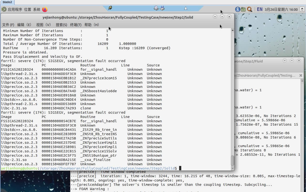

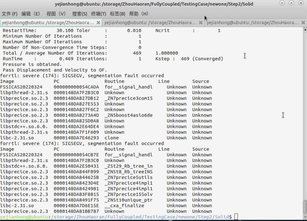

Firstly, thanks for your help!
In previous tests on our server(Kunlun 9016), we found the timing when such segfault happened has randomness. For an entirely same case, this segfault 174 happened at different times (please see the following pictures).
16.209s
0.469s
My colleague and I have checked our solver carefully during these days. Our solver has an interface to do one-way coupling in both window and linux platforms. Its stability has been tested by many cases. When we run our solver to do one-way coupling with openfoam, no segfault happens no matter in window or linux. Therefore, we assume the problem is data delivery.
So, I downloaded the latest version of OF adapter and modified it to meet our need. I rebuilt preCICE in debug mode on another small server and ran a simulation with less fluid mesh. The simulation has been running for days and the segfault has not happened yet. If the segfault happens again, I’ll post the information here to discuss. :grinning:

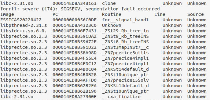

As far as I can judge, this issue was now fixed in Undefined behavior in communication · Issue #1243 · precice/precice · GitHub
Hi David,
It’s quite exciting to hear that this problem was fixed!
After the previous case was done, such segfault happened once again for another simulation(also running in debug mode).
segfault_part2
I’ll modify the source code as suggested in the topic and recompile precice again to check whether the problem still remains.
