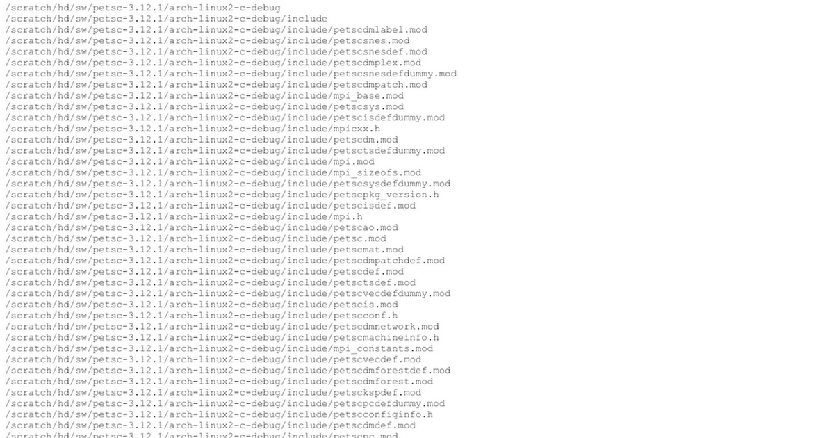

Can you please run the following command and attach the resulting petscfiles.txt
find $PETSC_DIR/$PETSC_ARCH > petscfiles.txt
Also, try to run cmake without sudo. It should not need the elevated privileges.
Finally, please remove the entire build directory to make sure that the cache is not messing with subsequent runs.

Regarding your petscfiles.txt, I see that you don’t have any CMake-related files (e.g. $PETSC_DIR/$PETSC_ARCH/lib/petsc/conf/PETScBuildInternal.cmake). How did you configure the PETSc build if not with CMake?
Here is how it looks for me: petscfiles.txt (588.0 KB)

The files are missing in the latest version of Petsc 3.12.1, but they are found in 3.11.4.
But the problem is still there. Although Petsc has no problem with MPI, preCICE cannot pass the parallel test. See below.
