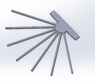

I’m currently working on solving a fluid-structure interaction problem using openFoam+calculix+preCICE, and have encountered a divergence issue in my computation. My model consists of a small convective cooling device surrounded by strips, with the overall device dimensions on the order of 10mm. The individual strips measure around 10μm in size, and the entire fluid domain spans approximately 100mm in scale. The model is shown as follow.
