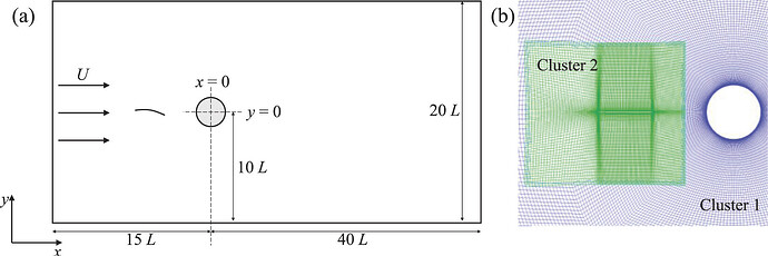

You can refer to the article DOI 10.1088/1748-3190/ac1cee, which appears to implement the fluid-structure coupling using overset grid.
