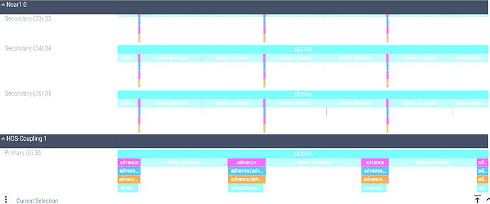

A snapshot of the trace is as follows and it is obvious that the data exchange cost huge amount of time in each time step.
I have attached my config.xml and trace.json files for your convinience. Any comments are much appreciated! Thanks.

These sizes together with this data setup means that the relaxation mesh alone contains 1.2 GB of data to be transferred. This data needs to be transferred, which results in the numbers you saw. There is not much you can do about this with your current setup apart from maybe switching to a faster network if available.
A possible solution would be to keep the size of the overlapping domain (MeshA) fixed and use vertex displacements to “move” it over MeshB.
This way the mesh is static from the point of view of preCICE. In SolverB you can then map between the reference mesh to the now internal MeshB taking into account the displacements.
Hope that helps!
